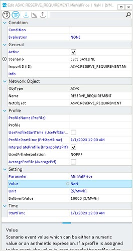

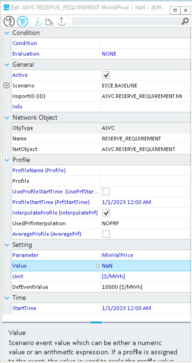

Hi @will, thanks for the beta. With the MinVal event, I’ve noticed that I’m unable to edit the Value field in the Event Editor - any numeric value that I enter into the field gets replaced by NaN. I see that there’s a default value for the event - is this value potentially conflicting with my custom value?
Hi @emmacooper
This is a known bug in v3.8 of SAInt. It will be fixed in v3.9.
If you simply close and reopen your scenario, the MinVal event will behave properly.
