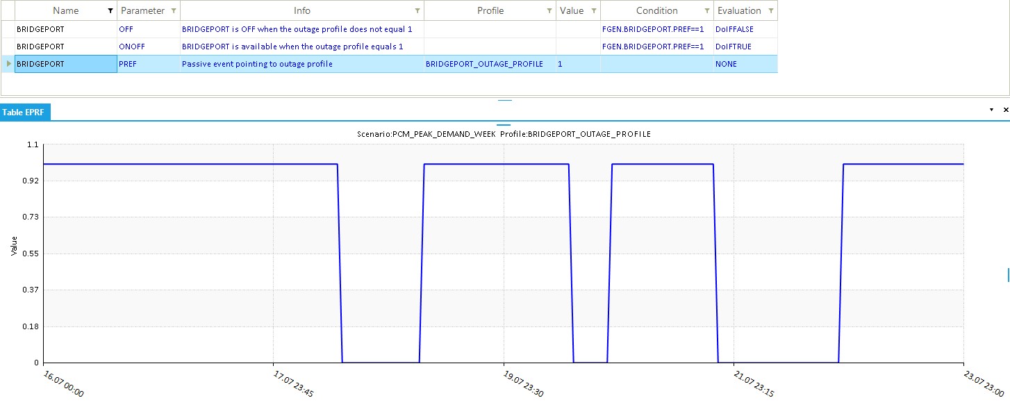

Thanks @will ! I tried to implement this with a custom outage timeseries for one of the nuclear generators in ENET39. Here is my profile that I loaded in:
And here is how I assigned it to a PREF event:
But the solution does not seem reflect the generator being offline during the specified outage times. In fact, the dispatch stack shows active generation during outage periods.
I’m wondering if I might’ve missed anything in my use of the PREF variable - please let me know if you notice anything incorrect! My other hypothesis is that my outage periods were too short - i.e. the nuclear generator didn’t have time to ramp down? However, the MaxRampDownRate was set to 1 MW/min. For a 650 MW unit, that means that it would take a little less than 11 hours to completely turn off from operating at full capacity. I believe that my outage duration was longer than 11 hours.
Thanks again!
Hi @emmacooper,
Thanks for sharing your information from trying to implement this!
It looks like you’ve configured the profile and the events correctly. Could you double check the time window for your generation data? In version 3.6 of SAInt, all of the dates are in the format “DD/MM/YYYY hh:mm:ss”. This means that the generation dispatch stack you shared goes from the 1 AM on the 1st of January to 12 AM on the 12th of January. Can you share what the generation dispatch for this generator is during one of the outages you specified?
Thanks!
I did format the dates incorrectly - thank you for catching that @will !

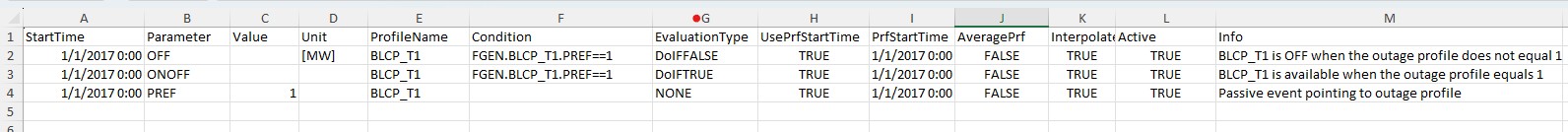

Hi Will, Thanks for the template link. for test purpose I created Scenerio Event profile with 1 machine. Please see the attached picture. When I tried to import this profile, It gives me these errors:
2025-08-19 11:57:28 [EROR] Line 2: Scenario parameter OFF not found!
2025-08-19 11:57:28 [EROR] Line 3: Scenario parameter ONOFF not found!
2025-08-19 11:57:28 [EROR] Line 4: Scenario parameter PREF not found!
2025-08-19 11:57:28 [EROR] Failed to parse file: No lines were parsed
Hi @aftabzmn1,
Thanks for sharing your update.
The “Parameter” column should specify the full description of the property including which object each event will apply to. I assume these events are for the generator “BLCP_T1”. Each event would have the following “Parameter”, respectively:
FGEN.BLCP_T1.OFF
FGEN.BLCP_T1.ONOFF
FGEN.BLCP_T1.PREF
