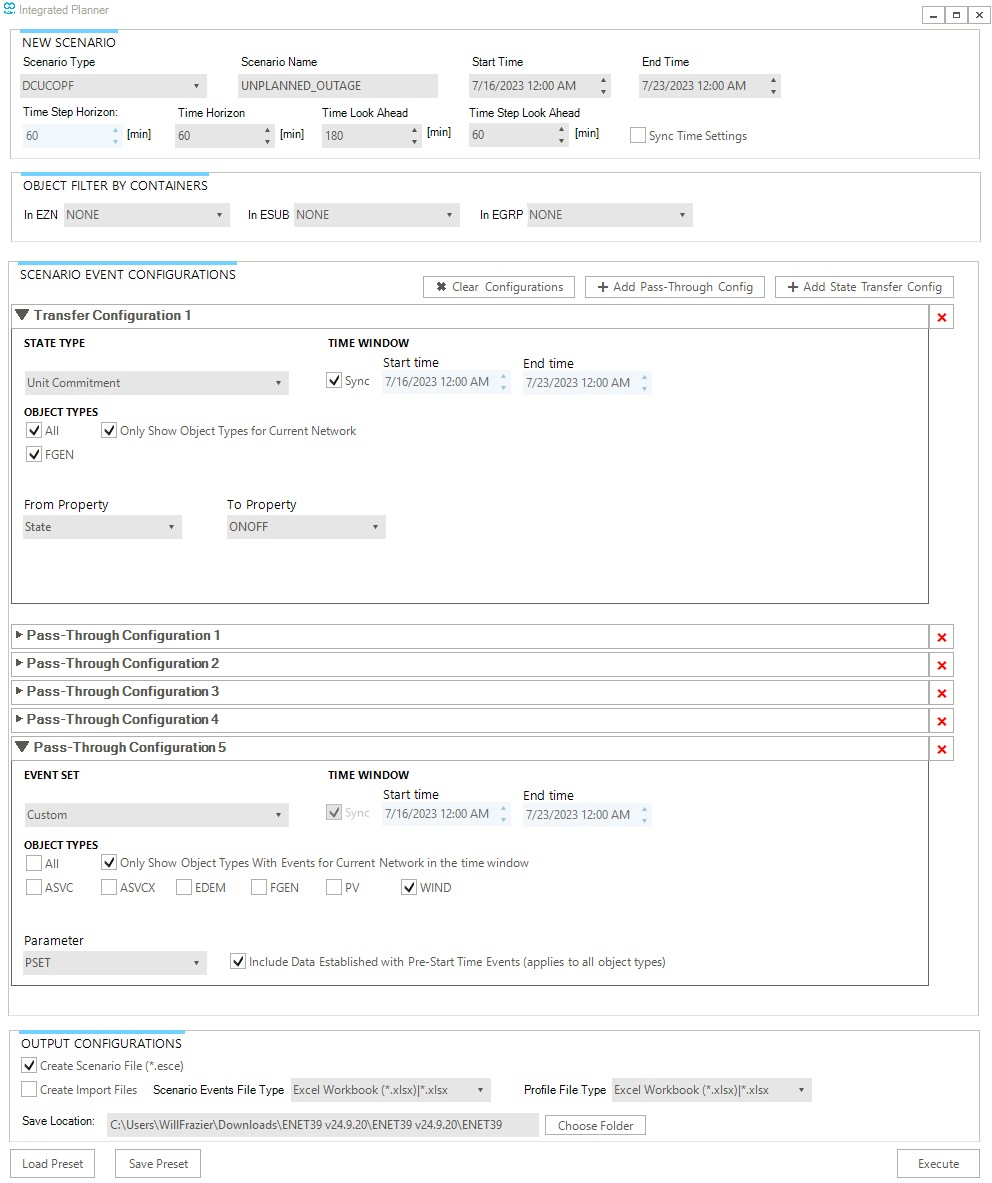

The first set of ON/OFF/ONOFF events in your “planning” scenario enforce availability and outage constraints on the optimal unit commitment decisions in that scenario. The second set of ON/OFF events enforce the unit commitment decisions from your “planning” scenario in your “operation” scenario. It would not make sense to include both sets of events in the same scenario, although there would never be an infeasible conflict between them. The unit commitment results are simply a further constrained set of the same events since they are the output of an optimization problem subject to the first set of constraints.
I hope this helps. Please allow me to explain little more about the “Integrated Planner”. There are two ways to send events to another scenario: “Transfer” and “Pass-Through”. “Transfer” is for results → inputs, and “Pass-Through” is for inputs → inputs. Notice in my screenshot above I use only 1 “Transfer” config for Unit Commitment. I then used “Pass-Through” configs for the remainder of my inputs, with the config for WIND PSET events shown and the others collapsed for the purpose of the screenshot.
When you create your “operation” scenario from the results of your “planning” scenario, you should not pass through the ON/OFF/ONOFF events from the original scenario if you are transferring the Unit Commitment results. Unit Commitment events are indeed passed as ON and/or OFF events and not ONOFF events. This is the intended behavior for the “Transfer” config: results from one scenario are sent as inputs to the next.
