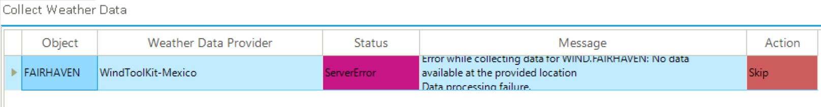

-I am trying to download wind data in collect weather data window following the steps mentioned in SAint document website, but it keep says Server Error. While solar data status is “downloaded”

Could you please share some additional information about the WIND objects your trying to collect data for? I see you have WindToolKit-Mexico selected as the Weather Data Provider. Does this align with the Latitude and Longitude properties of your wind object?

Thank you for the hint, I was being able to change the WIND objects’ Latitude and Longitude according to the Mexico .
After that WIND data downloaded successfully.
