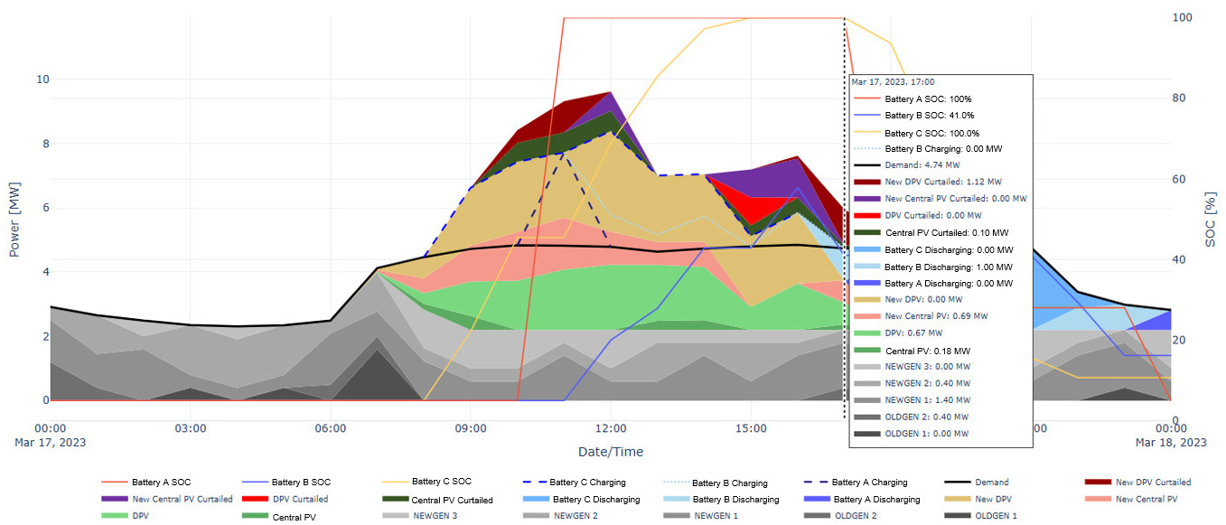

Hi,
I have a question about a specific dispatch result in my scenario.
In the attached screenshot (3/17 case with a 250 $/MWh curtailment penalty on New DPV), I see the following at 5 PM:
  • Battery B has a state of charge of about 41%.
  • At the same time, some New DPV is curtailed, and that curtailed energy has a 250 $/MWh penalty.
However, at 5 PM Battery B is discharging instead of charging.
Why does the optimization choose to discharge Battery B (1.00 MW) in this situation, when it seems like it could have absorbed some of the curtailed New DPV that carries the 250 $/MWh penalty?
Any hints on what model settings or constraints I should look at to understand this behavior would be very helpful.
Thank you!

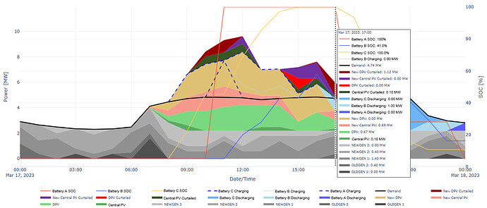

Plot with values

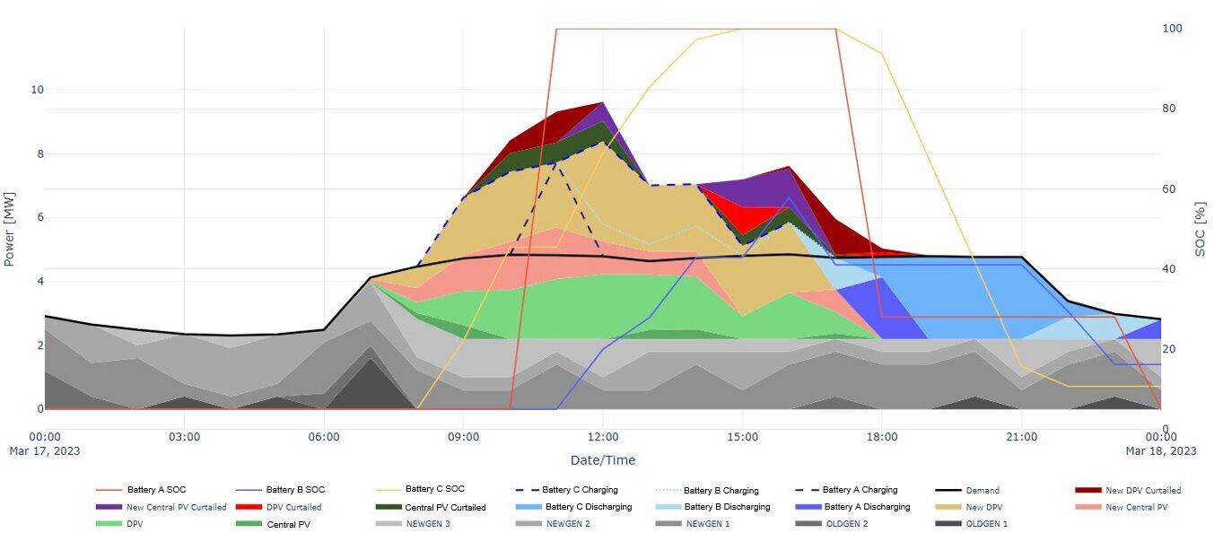

The same plot without values
